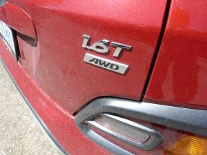

Limited and Ultimate trims get the underhood upgrade – a 1.6 liter engine with a turbo – and more horsepower.
This engine is paired with a more performance-minded seven-speed dual-clutch automatic and with – or without – AWD
An Ultimate with FWD stickers for $27,950. With AWD, the price is $29,350.

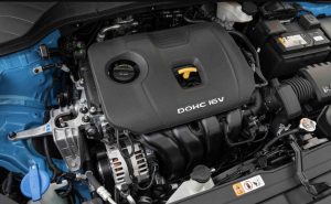

The Kona’s standard 2.0 liter engine – which makes 147 hp – is slightly more powerful than the only engine available in the Honda HR-V (a smaller 1.8 liter four that makes 141 hp) and just 1 hp shy of the Mazda CX-3’s also-only engine, a same-sized 2.0 liter four that makes 148 hp.
The Kona’s 2.0 liter paired with a six-speed automatic – not a continuously variable automatic – with either FWD orAWD.
So equipped, the Kia matches the performance – and mileage – delivered by its rivals.
But if you want to exceed their performance – without much of a mileage penalty – order a Limited or Ultimate. Both of these trims come standard with a turbocharged 1.6 liter engine that produces 175 hp and 195 ft.-lbs. of turbo-boosted torque at 1,500 RPM. This engine is the most powerful available in the class.
It is also paired with a different transmission – a seven-speed dual-clutch automatic. Together, the combo delivers zero to 60 in 6.5 seconds, the quickest-to-60 time in the segment.
To put this performance into context:
The one-engine-only HR-V needs more than 9 seconds to get to 60. Even the sporty-looking Mazda3 is far behind the hustlin’ Hyundai, taking about 7.2 seconds to achieve the same speed.
Amazingly, the EPA rated mileage numbers of the Kona’s turbo’d engine are only negligibly lower than those posted by the standard non-turbo’d engine: 26 city, 29 highway vs. 26 city, 30 highway.
Speed may cost money – but (in this case) it doesn’t cost gas money.
It also won’t cost you ASS. Neither of the Kona’s engines comes with automated stop/start, the “feature” that’s becoming hard to avoid in new cars that automatically shuts off the engine (and with it, in may cases, the AC) at every red light and pause in traffic – then automatically (but not instantly or silently) restarting it when the light turns green or traffic begins moving again.
ASS is marketed as a fuel-saver, but the savings are small – on the order of 1-2 MPG overall, maybe. At the cost of smoothness and quiet.
Bless Hyundai for not making it standard.
Performance is a Kona strong suit. Also how it’s applied. Which is via either a conventional six-speed automatic or (if you get the turbo) the seven-speed dual clutch automatic. Both shift through gears – as opposed to varying ranges – as the continuously variable (CVT) automatic in the HR-V does.
The difference in sensation – and sound – is marked, especially when you ask for rapid acceleration. Instead of a surge, shifts – and a reduction in engine speed with each shift up, which reduces engine noise.
CVT-equipped cars equipped with weak engines produce a racket rather than acceleration.
And with the turbo, it’s much less necessary to rev the engine, regardless – because of all that low-speed torque.
There’s also power to pass, which is sorely lacking in one-engine-only rivals.
The difference here is most noticeable when you’re on the highway and driving around 60 or so and need the beans to get around a tractor-trailer struggling to maintain 50. In the others, you might as well sit back and enjoy the wait because if you try to get around the rig you probably won’t. Not without becoming a chunk of grease in the arterial road, blocking the progress of everyone else trying to get around the rig.
Of course, the standard engine also suffers from the slows – but the point is you can opt out of the slows, which you can’t with the others. And you can still have a conventional/geared automatic rather than a CVT, which for some is a deal-breaker.
Another thing you can opt in – or out of – is AWD. Even if you do get the turbo. This is pretty unusual – and not just in this class of vehicle. The general practice, when a given FWD vehicle is offered with a high-performance engine, is to pair it with a mandatory AWD system. This does add tractability – the higher power distributed to the pavement via four rather than two wheels. In the Kona’s case, you also get a locking rear diff and a revised rear suspension designed to optimize the whole enchilada.
There is no question this enhances winter-weather grip as well as dry-weather handling.
But, the AWD just as unquestionably adds both cost up front as well as potentially down the road and weight all the time. You pay more – and you don’t go as fast.
Or as fun.
A bit less control can be just that. The driver modulating wheel-slip rather than the vehicle. And let’s be honest, it is fun to chirp the tires sometimes, especially in a vehicle that is built mainly to be . . . practical.

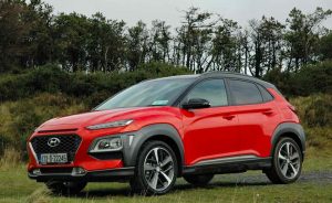

At The Curb

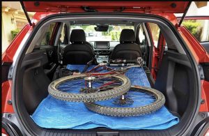

The subcompact Kona is only 164 inches long.
To get a sense of how small an exterior footprint that is, compare it with the footprint of a one-size-larger compact sedan like the Honda Civic, which is 182.7 inches long – a difference of 18.7 inches in length.
But the Kona has 45.8 cubic feet of cargo space with its back seats folded – vs. 15.1 cubic feet in the Civic’s trunk, which can’t be expanded because it’s walled off from the rest of the cabin.
The Kona’s space for cargo decreases with its back seats upright, but there’s still 19.2 cubic feet and it’s functionally more than that because of the taller roofline and because you can route cargo over the seats while people are still using them.
That’s something you can’t do in any sedan – without a Sawzall.
The Kona also has more room behind its back seats – and with its back seats down – than the Mazda CX-3 (17.8 cubic feet and 42.7 cubic feet) and nearly as much as the class-best (in the space race) Honda HR-V, which also has significantly more back seat legroom (39.3 inches) than either the Hyundai (34.6 inches) or the Mazda CX3 (35 inches).
But neither of them offer more than just practicality – which the Kona comes standard with with while also offering other things.
One such thing being a pull-up emergency brake lever rather than an electric parking brake. The latter is On – or Off – and so doesn’t give the driver much control over braking in an emergency. Pull-up emergency brakes allow the driver to manually modulate braking force, thereby bringing the car to a safer – controlled – stop in the event the primary (hydraulic) brakes fail.
The manually controlled emergency brake lever is also simpler. The lever is attached to a cable that cinches the rear calipers closed, slowing the car. The cable might break at some point, but it’s pretty . . . simple to replace a cable. It’s less simple to replace an electronically controlled parking brake – and almost certainly not cheaper.
There’s also matte-plastic fender flares, slit-eye LED lights and a kind of blackout treatment for the C-pillar that jazzes up the look just enough to make it interesting – which complements it not being disappointing when you drive it.
