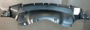

Many new cars are fitted with plastic underbelly pans – designed to smooth airflow underneath the car, for reasons of fuel economy as well as noise reduction. But these pans have to come off before you can access the car’s mechanical underbelly, including the engine oil drain plug (and oil filter, if it’s not topside).
With the car on a hoist and a technician able to stand/walk around under the car, removing the underbody pan isn’t that much of a hassle. It’s not so easy when you’re lying on your back, in your driveway.
Actually, getting the pan off isn’t too hard.
It’s getting the pan back in place that can be a pain. These things are often large and unwieldy. You have to line them up with multiple holes and then get the plastic tabs or whatever the fastener system is locked down without the pan moving out of position.
Here’s where a helper – human or floor jack – is . . . helpful. A second pair of hands to hold the pan in place while you get it fastened. Or, use the floor jack to do the same. The pan is usually made of plastic and isn’t heavy. It’s just awkward to get it lined up.
Be sure it’s reinstalled correctly before you lower the car and drive off. If it falls off with the car at speed, you will not be happy. Neither will the driver of the car behind you.

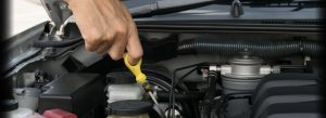

Also be exacting about the oil level. Too much can be as bad as too little. This, by the way, is one of the perils of having someone else change your vehicle’s oil. Quick lube places often use a pump to feed fresh oil to the engine, rather than pour the oil in one quart at a time, as you would at home. The pump system makes it easier to lose track of how much actually got pumped in.
If you have someone else change your oil, always check the level on the dipstick before you drive off.
