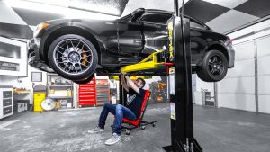

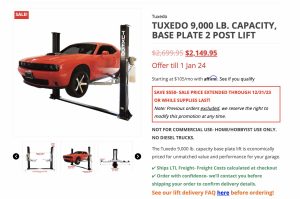

The answer hinges on many variables, not the least of which is how much you can afford to spend. If you’re like me, you probably cannot afford to spend as much ion a lift as it costs to buy another car – which is what you’ll be looking at spending on some of the fancier models.
You’ll also have to consider how much space you’ve got in your garage – as well as the capacity of your garage’s floor, if you’re considering a lift that bolts to the floor. It may be necessary to dig out the concrete that’s there and pour stronger (re-barred) and thicker concrete to support the posts, if the lift is one that has fixed posts that bolt to the floor.
And – of course – there is the matter of height. How high is the ceiling of your garage? If it is only seven or eight feet, you won’t be able to lift a car high enough to stand (or even crouch) under it – defeating the point of having a lift. You may also need to modify your garage door tracks, to make room for the lift (and your vehicle, when it is raised by the lift).

One I’ve found that might is the QuickJack 5000TL. It’s made by BendPak, which makes a variety of different home-garage lifts, including the kind that have posts and arms. Here’s what I’m liking about this lift:
It is portable and compact –
The lift consists of two scissor-jack ramps that are positioned underneath the left and right side frame rails; a power unit raises both sides at the same time, raising the car about two feet off the ground – provided ample working space underneath the car. When you’re done working on the car, the ramps can be stored out-of-the-way and so not in your way when you’re not needing the car to be lifted. If I ever decide to move, moving the lift would be no big deal.
It does not require reconfiguring my garage door tracks –
The car is lifted up – but not so high that there are potential interference issues with the garage door tracks (or the ceiling). This is a lift I could use right-out-of-the-box, without having to first figure out how to make it usable in my garage.
You can pick it up at places like Wal-Mart without needing a forklift –
The whole lift only weighs about 300 pounds. A two-post lift (even for a home garage) might be so heavy that the only way you’ll get it to your garage is by using heavy-lifting equipment. And (per earlier above) you may need to reinforce the concrete floor of your garage to safely bear the weight of the lift and your car.
It is affordable –
This is a big one, for me. Also probably for you. My buddy Graves (who is a professional mechanic and so I value his judgment) encourages me to go with a traditional two-post lift like this one – made by Race Tools Direct. It would raise my car much higher – but the price tag is also about 50 percent higher than the $1,300 or so the QuickJack goes for at Wal-Mart and not counting what it costs to have the almost 1,300 pounds of the thing truck-freighted to my house.
I haven’t come to a decision just yet, but I’m leaning heavily in the direction of the one I can afford. Of course, Graves will probably say I can’t afford to risk crawling around underneath the one I can afford.

get the 2-post!!

I know of two people who both got used 2 post lifts. Price of course varies but it might be an option as shops replace older lifts that aren’t capable lifting those Eco friendly 6,000 pound EVs.
Assuming you have the ceiling height a four post lift will work also and some of the newer ones come with wheels allowing for easy movement and as a bonus you can buy another car and park it underneath. Sadly I don’t have the ceiling height to do that. 🙁
