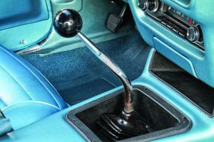

Which brings me to the real point of this article. Which is that it’s possible – it’s easy – to make the conversion from automatic to manual. If you want to do it. And if you have a car like mine. Not the same make or model. Just a car like mine. That is to say, a car made before electronic kudzu made it effectively impossible to do.
All you require – as the Toothless Man once said – are the necessary parts to make the conversion, such as the pedals, levers and brackets. That and the transmission, of course. Plus the manual flywheel and bellhousing, clutch and pressure plate, etc. It is an entirely physical conversion as there are no electronics involved. And that is why the conversion is possible – and why it isn’t with anything that’s been made since the electronic kudzu’ing reached a certain degree of interconnectedness, which was probably roughly about 20 years ago.
Each car is now a bundled package of electronically connected components, including its mechanical components. My ’76 has no consciousness of the kind of transmission it came with nor does it care whether I convert it to a different one. I have in fact already done just that – about ten years back. I swapped out the three speed automatic it came with when it was new because I wanted a transmission with overdrive, in order to lower the engine’s revs at cruising speeds. All modern automatics have overdrive gearing to do just that. It was easy to bolt in a more modern automatic with an overdrive gear because all that was involved was bolting it in. My Trans-Am does not have an ECU that remembers what transmission type was bolted to the engine originally and there is no interconnectivity beyond the physical connections.
If it bolts up, you can literally bolt it up.
This is only part of the process with an electronically controlled car. The ECU that runs not just the engine will know something’s been changed and may not accept it. If it’s anything made within the past decade or so, it won’t accept it.
It has gotten so panopticon-ish that you can’t even replace a headlight assembly or battery in some cases without the computer’s approval. If you don’t get it, you won’t be goin’ any damn where (again, per the Toothless Man).
It is essentially impossible to convert a modern muscle car such as the Dodge Challenger Hellcat I was lucky enough to test drive last summer from automatic to manual. You’d have to replace not just the transmission but most of the electronics. You’d probably have to swap an entire/complete drivetrain (engine and transmission) plus all of the latter’s computers (plural) and sensors, etc. to get it done – and make it work. And that would more expensive than just buying a Challenger that was factory built with a manual.
No such worries with a pre-electronic car like my ’76 Trans-Am, which I can make much more like my other ’76 Trans-Am.
It’s just a matter of acquiring the parts and bolting them in.
