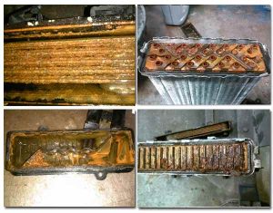

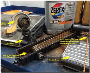

It’s also smart to drain the cooling system on roughly the same once-every-five-years schedule and refill the system with fresh coolant as this will extend the working life of expensive parts such as the radiator and hard-to-get-at parts like the water pump and thermostat, which are often (in newer engines) buried deep underneath an array of other parts that have to be removed first, before it’s possible to get at parts like the water pump and thermostat.
