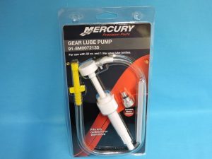

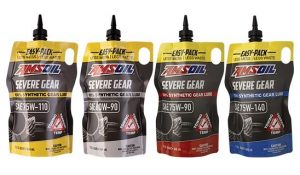

Then I added eight pints of fresh – and honey-colored – lube to the transmission, which I swear made purring sounds as I did so. This job, if you’ve not done it, looks tough but is mostly just messy. It’s easier if you use a hand pump to transfer the lube from the bottle it comes in to the transmission. Or you can use AMSOIL – which comes in a clever squeeze bag which eliminates the need for the hand pump. But if you haven’t got a pump – and don’t use AMSOIL – you can use a section of flexible rubber fuel hose to feed the lube into the fill hole from the plastic bottle most other brands of gear lube come in. Cut a length of line to suit, put one end on the bottle’s nipple, the other in the hold . . . and squeeze!
This takes longer, but it’ll git ‘er done.
Be sure to fill until the transmission dribbles. Make sure you’re not getting a false positive. Wipe the area outside the fill hole clean to make sure. If a little lube is seeping from the hole, you’ve filled it. Now install the plug, being careful not to overtighten it. Most transmission cases are made of aluminum – and if you want a problem that’s not easily fixed, you don’t want to crack the case. A little more than hand tight is usually just about right.

      • eric, I forgot to ask if you used Amsoil. I suppose that’s a silly question. I do know transmissions will operate much more smoothly with synthetic.
        I was driving a newly rebuilt(ha, just a couple parts or so)Pete with a 10 speed and the boss called to ask how it was doing. I replied, Chining like hell, and he got mad. I lived with it a couple weeks and got tired of it. I knew the home office would reimburse me for whatever I did to the truck so I picked up 5 gallons of synthetic fluid for it. It was the difference in night and day. I never mentioned it although he got a bill from a shop for putting it in. I was trying to miss as few loads as possible and keep that sumbitch alive.

      • eric, Amsoil came out with those squeeze packs right after I bought a 6 or 7 quarts….dammit. I have to wonder how much that took off the life of that transmission although there’s no way to know.

      Maybe other synthetics would do it too but I use Amsoil. It’s quite a huge jump from regular ATF to a synthetic. I mentioned it to a son/father transmission shop who do a lot of bidness. They both acted as if I hadn’t even said anything. I laughed myself right out of the place. No way in hell were they going to put synthetic in a transmission, probably not in any that call for it specifically. Not good for bidness. They looked at me like STFU and go on. I did but with a big grin on my face. FEFEFH’s.
