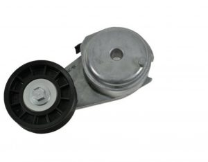

My reply: There may be reason to be worried – but hopefully not. Odds are the screech is emanating for one of two and possibly both reasons. The belt that drives the engine-driven accessories may be slipping/failing and/or the tensioner pulley that maintains the correct . . . tension on the belt may be failing. There is a simple, no-tools-required way to diagnose this.

Release the tension on the belt using a wrench or socket on the tensioner pulley; slip the belt off the pulleys, talking care (take a photo) to note the proper routing of the belt so that the new belt is installed correctly. With the belt off, check the tensioner pulley for free play and any weird noises by spinning the pulley. If it doesn’t wobble or sound scratchy and turns freely it is probably ok.
Now route the new belt over the pulleys and snap it into place using the tensioner pulley. Double check the routing and then start the car and see whether the noise has gone away. If it is still there, the problem is probably the tensioner pulley.
