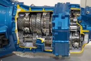

Manual transmissions are interesting things in that they are probably one of the last things about moden cars that haven’t been turned into electronic things.
They are still essentially mechanical things – gears and synchros, rods and forks. The works turned by mechanical force, a physical clutch and flywheel, the interaction controlled by another non-electronic thing (that’s you).
Essentially the same now as they were fifty years ago, when cars were still largely mechanical things.
They are much simpler things for this reason than modern automatic transmissions – which used to be essentially hydraulic things but which have become as electronicized as the engines they are bolted to.
This has made them very complex things. Which has also made them very expensive things.
It has also made them more failure prone things, simply because there are so many potential failure points.

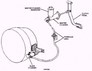

Modern manuals – which encompasses most installed since the ’80s – have hydraulically assisted clutches, which makes the clutch easier to work. Many also have automatic self-adjusting clutches, further reducing wear as well as maintenance.
The weak point – if you let it be – is the hydraulic circuit that serves these purposes.
It consists of a slave cylinder – which is very much like a brake master cylinder – and works on the same principle. When you depress the clutch, you are actually displacing fluid, which cannot be compressed – multiplying the force applied by your depressing of the clutch.
But just like a brake master cylinder/circuit, the brake fluid inside the slave cylinder goes bad over time. And so will the slave cylinder, if you don’t regularly change out that fluid. Many people are unaware of this need-to-do item or forget to do it and they end up paying for it.
If you want to avoid that, don’t fail to do it (or have it done) at least once every five years.
