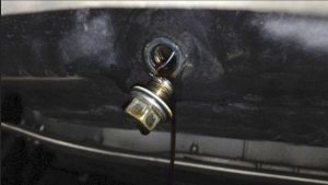

Another good thing to check before you leave the shop’s parking lot is whether anything’s dripping that wasn’t before. If it wasn’t, then it shouldn’t be. If it is, then you might have either of two possible problems – one of them serious. The first of the two is that the technician over-tightened the new oil filter. This can over-compress the gasket between the filter and the engine, resulting in leaks. It can also make it a pain to get the filter off next time.
The other source of drips is a drain plug bolt that was cross-threaded stripped when the technician re-installed it. When this happens, the technician may not want to tell you he did it – for all the obvious reasons. A cross-threaded bolt hole can usually be repaired, but it involves time and some skill to do that. It may require replacing the oil pan and that’s not cheap and guess who’ll be paying for that if the technician owns up to damaging it? So he might just put the drain bolt back into the damaged hole and hope it holds – for just long enough to establish plausible deniability. If the bolt works loose after you drive away and you lose all the oil in the engine – and end up needing a new engine – the shop may disclaim any responsibility and leave you holding the bag.
Even if it is just a leak, due to oil seeping past damaged threads, it’s still a pain to repair the threads and not cheap, either – if you have to pay a mechanic who knows how to use a tap and die set to do the repair.
You can greatly reduce the chances of this happening to you by letting the vehicle idle for a couple of minutes and then looking underneath where you’re parked for any drips on the pavement. If you find any, do not leave the shop’s parking lot. Go back in and tell the counter guy about the drips and ask him to put the car on the lift to look and see why. Ask to be allowed to come into the service bay to see for yourself. There should be no oil seeping from the drain plug bolt. And you ought not to be able to wiggle the bolt. If you can, the threads are probably damaged – and you’d better make sure it gets fixed before you drive the car off the lot.
