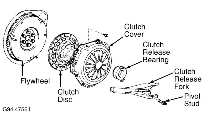

Eventually, everything that wears, wears out. But eventually can be farther down the road. A clutch – more finely, the clutch disc – is a wear and tear part, very much like brake pads in an almost literally the same sense. When you release the clutch pedal, the clutch disc grabs (and holds) the flywheel that spins and thereby mechanically connects the engine to the transmission – which then transmits the running engine’s power to the wheels via the driveshaft. This is why – in a car with a manual transmission – it is necessary to push the clutch pedal in when the vehicle comes to a stop – if you don’t want to stall the engine. Because the engine – even if it is very powerful – does not have enough power to spin the Earth.
So, the wear and tear that eventually wears out a clutch occurs during the engaging and releasing of the clutch, very much in the way that brake pads wear out over time by pressing down on the brake pedal, which causes the pad material to come into contact with the spinning surface of the brake rotor; the friction from this contact wears away the material. This is inevitable – assuming you want the car to slow down. But you can slow down the progression of wear by anticipating the need to slow down and using aerodynamic drag and loss of forward momentum to slow the car before you begin to apply the brakes – and by braking progressively rather than by flooring the brake pedal suddenly. Such practices can greatly extend the service life of brake pads (and rotors).
Clutches aren’t much different in this way. You can decrease the wear – and so extend the service life of the clutch – by driving in such a way as to reduce the friction that inevitably wears out the clutch.
