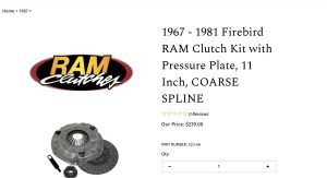

In a couple of weeks, I hope to be able to order the manual flywheel and clutch/pressure plate. One of the great things about that is it’s much easier to install those things than it is to get an automatic transmission back in the thing – because the flywheel is relatively light and manageable by one man, by hand. An automatic isn’t. You generally need the help of a floor jack and maneuvering it into alignment with the mounting points on the back of the engine is a workout (though you can make this job easier by installing some studs in the bolt holes on either side of the back of the engine and use them to guide/align the transmission into position).

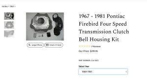

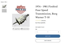

I’m hoping to be able to order the bellhousing by Feb (funds permitting) and then I can finish all the pedal linkage stuff. Once that’s done, the only thing left to do will be to install the factory Super T-10 four speed, which will be easy also – once I scrounge the money to pay for it!
