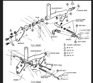

Installing the all-important third pedal – the clutch pedal – is also made easy because GM left a guide for where the hole for the rod that goes in and out (operating the clutch) when you push down on the clutch pedal is supposed to go. There’s a black plastic trim plate just above the carpet with a slot – and that’s where you drill. The rest is as easy as pushing the rod through the hole and securing the other end to the Z bar with a snap clip.

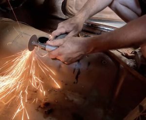

There’s still a hole – for the shifter lever – that must be cut through the driveshaft tunnel but that is also just grunt work because it’s obvious where the hole needs to go and once you’ve cut it, there’s a factory-style hump that goes on top, to which the boot/trim bucket bolts. It’s not rocket science.
