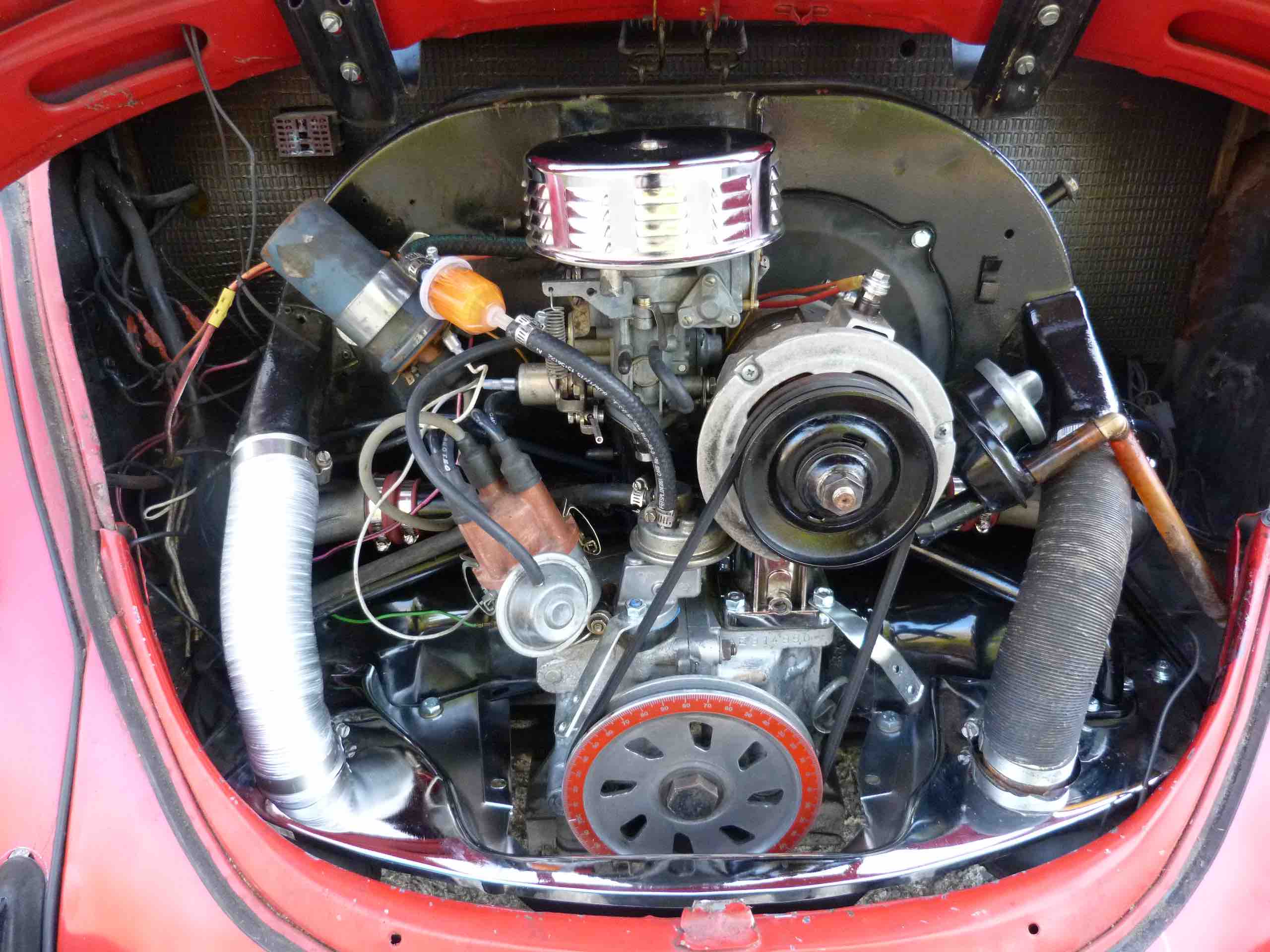

Well, the ’72 Beetle is almost road-ready.
The mechanicals mostly are.
The Yeti-abused intake manifold has been repaired; new, non-leaking boots – the correct Solex carburetor installed and adjusted. Some shady electrical connections remedied. She lives!
And has heat! A little PB Blaster on corroded cables and some cleaning got the Beetle’s ductwork viable again.
Now it’s on to the brakes/suspension – which may not need much work; will have to pull wheels and have a look. We shall see.
One nugget of info to pass on to those of you out there who might be interested in fiddling with an old Beetle yourselves. This one – a ’72 – came with an alternator. Not from the factory, though. It was added by the previous owner.
Originally, the car had a generator.
Now, this is an important point. If you want full throttle.
Or the right carburetor.
Here’s the problem: The alternator’s case is wider diameter than the factory gennie’s is. This creates clearance issues with the Solex 34 Pict 3 carburetor. Specifically, with the accelerator pump linkage. It rubs up against the case; the throttle is impeded from opening more than about half way.
The rigged “fix” – what the previous owner did – was to install an offset adapter plate (and use the wrong – smaller – 28 Pict carb). This genius being the same genius who used a hammer to smash off the EGR port on the intake manifold, creating a massive vacuum leak he fixed with an old bolt daubed with RTV.
Sexual chocolate!
Anyhow, the right fix is easy. Just reverse the accelerator pump cam/linkage, then readjust to get the proper geometry. With that done, you get a full stroke without clearance issues – and without mauling the carburetor or the alternator (some geniuses try to obtain clearance by beating on the alternator case).
The car runs great now. Amazingly great.
It starts immediately, despite the absence of a computer and notwithstanding the fact that it’s carbureted. Pulls strong  – well, for a Beetle. Strong enough to be daily-drivable. It maybe could use richer main jetting to account for the ethanol-adulterated “gas” we’re forced to feed it. But that is easily – and cheaply – dealt with.
That is the magnificence of these old jalopies. A teenage kid with teenaged kid resources can deal with one. A new main jet is $5, maybe. A screwdriver and some gumption are all that’s necessary to install it.
This is true of pretty much everything – every system – that makes the Beetle go. Need a new fuel pump? It’s two 13 mm bolts to take out – and the pump costs $20. It is not located in the gas tank. Does not cost $450 for an “assembly” (as is true of the “fuel pump assembly” in my ’02 Nissan Frontier).
One belt. Shim the thing to adjust.

  1. 1. I wouldn’t rejet the carb until you get the correct air filter housing on it.
    That chrome housing is causing the carb to run lean, there’s a stand-off space which is supposed to be right above the carb air inlet. That housing sits too low and will lean the carb out. stock air filter housings have the correct stand-off spacing.
    No, a stock housing will not choke out a stock engine excessively.
    Use simple green or any of same type cleaners to soak and clean the horse-hair filter element. Std 30w engine oil works fine.
    `72 may actually be a paper element but I don’t recall for certain.
    Also those carbs are jetted somewhat lean to begin with, thanks to smog law BS. That air filter housing that’s on there now will make it worse.
    2. no need to rejet due to todays fuels, my `70 beetle has no complaints or jetting issues with todays gas. It runs just fine on 87 ethanol. (1600 single-port. PICT 30-1 carb)
    3. get rid of that rubber hose you’re using for vacuum to the vacuum advance on the dist. It’ll allow fuel vapors to collect & condense in the vacuum advance can and eventually destroy the diaphram.
    No, there are NOT reproduction diaphrams available, take care of the one you have.
    A simple fix, get some copper tubing to match the vacuum fitting dia, use a tubing bender and make a full loop in the tubing at the TOP of the tubing where it connects to the carb. That’ll form a water trap and hold any vapor condensation.
    4. DO NOT use the cloth-covered fuel lines that’re currently available for the beetle, they are NOT the same quality as years ago.
    use the std fuel lines such as for your T/A, with good hose clamps.
    Also,
    CHECK THE FUEL LINE BEHIND THE FAN HOUSING.
    If you don’t know how old it is, change it, as in NOW. And get used to changing it every other year, regardless of it’s condition.
    5. that dist appears to be a reproduction version of the early style ‘large can’ vacuum advance distributor. It may not be correct for the PICT 34, which would likely have what’s called the ‘push-pull’ type vacuum advance. This would be a vacuum advance with two hose fittings on it.
    check the L / H intake casting and see if there’s a vacuum fitting on the top corner towards the cylinder head. If so, that’s an indication of what the car originally had and if that carb is correct for the car, you’d need the carb body ID number to find out what actual distributor number would be correct for that carb.
    It is surprising how many different dist- carb combinations there are for air-cooled VW, and it is critical, especially for those engines to survive in the summer heat.
    Whats on that car now is correct for a carb like mine, but it may not be correct for a PICT -34.
