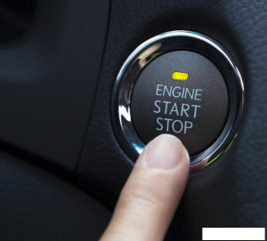

There is this thing called the ignition switch, for openers. The same switch that one uses to turn the engine on can also be used to turn the engine off. This will cause the car to slow down.
Cooper’s BMW may not have had an old-school ignition switch/key. Many late-model cars also use electronics to turn the engine on, too. But there is still an On – and an Off – button. If you push the button for Off, the engine will generally turn Off.
This is the intended purpose of Off.
Of course – for saaaaaaaaaaaaaaaaaaaaaaaaaaaaaaaaaaaaafety – it is often the case that one must press and continue to press the Off button in order to override the saaaaaaaaaaaaaaaaaafety protocol built into the thing by the manufacturer. It can take several long-feeling seconds between the pressing and the shutting off.
Still, the fact remains: The engine will probably turn off. Unless HAL 9000, of course.
Drivers are not told this – and few (apparently) exert the initiative needed to cause the owner’s manual to convey the protocol to them, so that in the event their vehicle accelerates in an unwanted manner, they will know how to put an end to the show.
Instead, they touch the button, briefly – and nothing happens. Cue mess in pants.

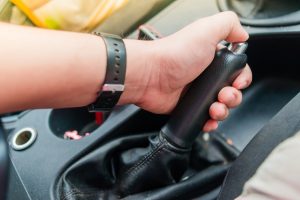

A second method – in the event the engine cannot be turned off due to some evil electronic genie – is to disconnect the engine from the transmission – and thus, from being able to continue imparting force to the wheels, thereby causing the vehicle to cease accelerating – even if the engine still is.
This is achieved by moving the gear selector into neutral. It works the same whether the car has an automatic or manual transmission. The problem here, though, is that gear selection is also often no longer mechanical in many – most – new and late-model cars. A sensor detects the range selector being moved from Drive to Neutral or some other range. Then the computer signals the transmission to shift to the range selected.
But what if the sensors do not detect it?
It’s at least worth a try.
You can also depress the clutch – if the car is equipped with a manual transmission. That one is evil genie proof.
Incidentally, this will not blow up the engine – unless the car is extremely old.
Every car built since the late 1980s has computer controls and one of these controls is a rev limiter. It prevents the engine from being over-revved (we used to call this red-lining it) for the express purpose of keeping the engine from over-revving, with the attendant mechanical catastrophe in the event it did.
Try it yourself and see. With the engine warmed up, and the transmission in Neutral (or Park – assuming the car is not moving) floor the accelerator pedal and hold it down. The engine will rev to near redline but the electronics will prevent it from exceeding redline.
In any event, Cooper could have put the transmission of his X3 into Neutral. The BMW would then have coasted safely to rest. He could also have geared down, to reduce his speed. By moving the shift selector from Drive to 4 then 3 then 2 then 1, he could have used mechanical leverage to whoah nelly! the BMW.
