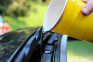

The drain holes connect to tubes that route the water underneath the car, kind of like the AC condensation drain hole (the water that you see dripping underneath the car in summer comes from that). So, with the drain holes open, pour a little water in the drain channels around the perimeter of the sunroof, in the drain channels (roof open).The water should drain through the holes and then drain underneath the car somewhere – probably just aft of the front tires, near the A pillar at the windshield base.If the water backs up in the drainage channel or does not drip underneath the car, the tubes are likely clogged.
You can try to clear them using compressed air – not too much! You don’t even need an air compressor to do this. Get an aerosol can of keyboard cleaner – compressed C02 – and use that in each drain hole. Then try the experiment with the water again to see whether it drains.
