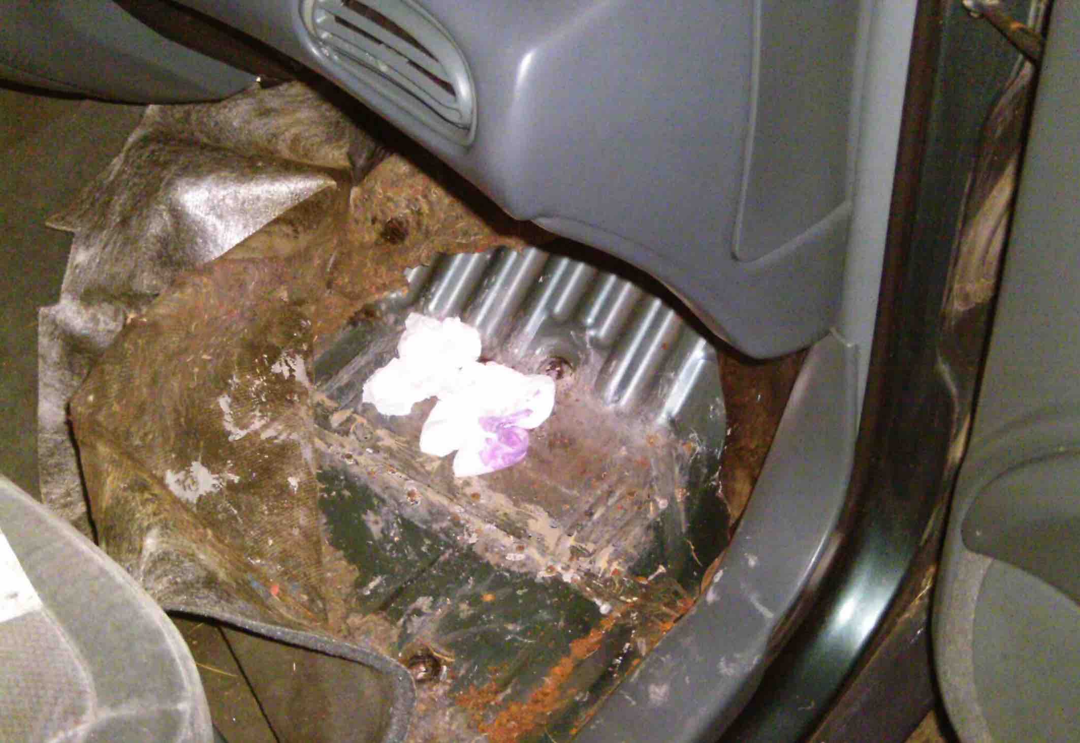

The smell of a leaking heater core. Accompanied by the sight – of greasy steam rising from the passenger side floorboard, which quickly becomes a film that coated the inside side of the windshield and side glass. Soon, you won’t be able to see where you’re going anymore – unless you use a rag or even just your hand to clear a hole.
A leaking heater core is among the most unpleasant automotive failures – especially when it happens in winter. Few earthly delights can compare with having to drive in freezing weather with both windows down – to vent the steam – while you nervously eye the rising temperature gauge (due to hemorrhaging coolant) and hope you’ll make it home.
In case you don’t know why, I’ll explain:

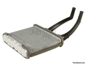

The heater core is basically a small radiator that’s buried deep inside the dashboard. Warm engine coolant flows through the heater core to keep the car’s interior warm when it’s cold outside. It’s free heat, too – at least in the sense that it does not cost you anything extra to keep warm. The system simply makes use of the heat generated by the engine to keep you warm. In a battery powered device – that is, an electric vehicle – there is no engine and so no heat except that which is generated by burning electricity. That depletes the charge available to keep the device moving, which presents a rather interesting Catch 22 in the wintertime: Do you want to make it where you’re headed? Or do you want to stay warm?
The downside to free heat is that just like the radiator that cools your engine, the heater core that keeps you warm when it’s cold out eventually springs a leak. This happens due to metal (or plastic) fatigue, the effects of corrosion and so on. It is an inevitability, too. Keep a vehicle – any vehicle – long enough and you will, one day, smell that smell.
That day arrived the other day. My Nissan pick-up is 23 years old, so I wasn’t surprised when I smelled that smell. Just not exactly ready to deal with it. No one is ever ready to deal with a leaking heater core. It just happens one day and then you have to deal with it.
The good news is, it’s easy to deal with – in the sense that you won’t be immobilized by a leaking heater core. If you’ve still got a long way to go when you first smell that smell, the thing to do as soon as you can is to find an auto parts store and park. Then pop the hood and let the engine cool down. After about 30 minutes, you ought to be able to loosen (don’t entirely remove) the radiator cap, to release the pressure within the system. Use rag over the cap to protect your hand from hot steam/coolant.
Now look around for the two smaller diameter hoses that run from the engine to the firewall, usually on the passenger side. These are the hoses that circulate the warm engine coolant through the heater core. What you’ll want to do is disconnect them from the fittings and then splice them together – using an appropriate piece of pipe the correct diameter to fit the two together. The auto parts store will have what you need – including some hose clamps to tighten up the spliced line and fresh coolant to top off what leaked into the passenger compartment (your front seat passenger side’s carpet is probably wet and – later on, when you get home – you will want to dry it out to get rid of the smell and to avoid getting rusty floorpans).
Now you can drive wherever you need to go – even if it’s across the country. But you won’t have any heat.
To get the heat back, you will have to replace the leaking heater core with a new one that doesn’t leak. The bad news is that while a new heater core is – generally – not an expensive part (mine cost about $60) the labor to have it installed is. Because it generally requires extensive labor to get at the old, leaking core. As in major disassembly of the vehicle’s dashboard. Because the heater core is one of the first components installed during vehicle assembly; everything else comes after – and so in the way of removal.

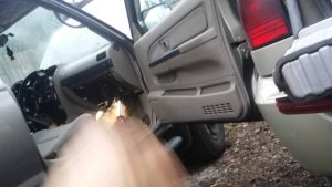

In the case of my old truck, it’s not all that bad. One of the reasons I cling to my old truck being the fact that it was designed in such a way as to make most repairs relatively easy. To get to the heater core, remove the glovebox – six screws – which exposes the heater box. Then disconnect the AC lines that plumb into the box (I have a mechanic friend who is a “certified” AC tech and so I can use his machine to save the refrigerant rather than lose it to the air) and remove the heater box. Now you can get at the heater core, which slides in and out like a cartridge-style cabin filter.
So that’s what I’ll be doing over the weekend.
