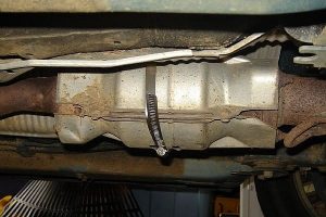

One common – and alarming – noise that modern cars often make that isn’t usually something to worry about is an exhaust rattle. It’s probably not a death rattle. It’s a good bet the catalytic converter heat shield – a thin piece of metal tack-welded to the converter’s body, to prevent its very hot surface from touching – and possibly igniting – dry leaves and such underneath the car – has come partially loose.
When it does, it makes an obnoxious racket – and if you don’t know about the heat shield’s propensity to work itself loose over time – you might think there’s something badly wrong.
The fix is as easy – and cheap – as having someone who can weld tack-weld the shield back into place or (field expedient) just pry the thing off. This will not affect the car’s function – or emissions – in any way.
Just remember not to park over dry (and tall) grass – until you can get the shield repaired.
