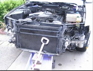

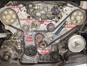

It is not nearly as easy – and it is almost always much more expensive – to do this job on a typical modern front-wheel-drive/AWD car with a sideways-mounted engine.
The water pump will be tightly packed on the side of the engine rather than facing you – up front – and getting at bolts and so on will require specialized tools and experience/skill. It may be more involved than just that, too. Some late model vehicles have the water pump buried deep inside the engine’s guts, requiring major disassembly of both the car and the engine to get at the pump. This is professional mechanic-level work and you will pay him accordingly.
A job that used to cost less than $100 that anyone who wanted to could do themselves, probably, has become a job that very few have the tools or skills to do themselves that can (once again) cost $1,000 more to get done by a professional.

If I ever found out the water pump was buried in the block, I would probably cry. Then I would find the person who designed the engine, and make him/her eat the block with a sledgehammer!
I’ve often thought that taking automotive design engineers hostage and forcing them to disassemble their own cars and put them back together using basic hand tools…and delivering progressively stronger electric shocks when they fail…would be worth the time spent in prison afterwards if it led to cars being designed by people with both the brains to do it correctly and the fearful incentive to do so.
Hi LetMe –
I don’t blame the engineers. Their task is designing what they are told to design. The car manufacturers want cheaper production costs and the engineers go to work on that. It works a lot like working at CNN, I imagine. The “reporters” report what they’re told to report – and how. He who pays the piper calls the tune!
I believe some smaller Ford engines have a glaring problem with water pumps, that when they leak (always eventually), they leak into the engine instead of outside the engine, causing engine failure. Not sure which engines, but I know one I had in an escape was one of the culprits.
Daughters Acura V6, the water pump buried behind the front engine cover. Dandy! Just replace it along with the cam drive BELT when you finally unbury it all. I watched a video and promptly sent it off to a trusted local shop when the BELT replacement mileage came up.
My 2003 V6 Ford Escape – CHAIN drive cams, no belt. The water pump sits behind the fwd cylinder head totally in the open, driven by a cute little belt off the cam end that is easily replaced.
