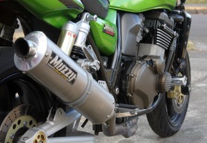

Well,  it turns out that I have become that guy.
The how-it-happened matters less than it did happen. I let my ’03 Kawasaki ZRX1200 – which is the only motorcycle I ever bought brand-new and also one of the very last liter bikes sold without a computer or a catalytic converter and with carburetors rather than electronic fuel injection – sit on its side stand collecting dust in the garage for (I’m wincing now) nearly a year without even rolling it around the garage. No surprise, when I decided the other day to take it out for a ride, it did not want to start and it wouldn’t idle unless I kept the revs up and then it spat and backfired through its Muzzy muffler like a it was running on three rather than four cylinders and the other three were misfiring, too.
I knew right away what it was.
Guilt comes easy to those who are (assuming they aren’t a politician). The problem was due to a two-fold, compounding mistake on my part. The first was that when I last rode the bike sometime in the fall of 2024, I filled it up with E10 – which is “gas” in the same sense that a zinc penny is the same thing as copper pennies.
Maybe not quite as bad as that. But not far off.
E10 means only 90 percent gasoline. The other ten percent being ethanol alcohol. There are many reasons why E10 is a gyp – like a zinc penny. The first being you’re paying for gas but getting 10 percent less gas. The second being that ethanol has a lower BTU content than gasoline, which means more of it must be burned to get the same energy as you would from a lesser amount of gasoline. This means your vehicle goes less far on E10 than it would on a gallon of E10.
The problem is that most “gas” stations only sell E10 – making it harder to fill up with gasoline. There is a gas station not-too-far from me that sells 100 percent gas and I usually fill the tanks of my motorcycles and especially my old muscle car with it – not so much because I am worried about not going as far on a tankful but rather what a tankful of E10 might do to my motorcycles and my old muscle car.
You may already know what I am getting at – which is that alcohol is a problem fuel when it is used in older vehicles with fuel systems designed for gasoline – rather than 90 percent gasoline. The stuff is hard on rubber/plastic parts not designed to handle alcohol-laced “gas.” If left long enough in the fuel system of a vehicle not designed for high-alcohol-content fuels, it might turn those rubber/plastic parts to goo – and goo tends not to flow too well through small-diameter orifices such as jets inside a carburetor.
The other issue is corrosion – from the inside out. Alcohol-laced fuels can lead to water pooling in your “gas” and in the float bowls of your carburetor(s) and that can lead to the symptoms my ZRX was manifesting.
I decided to treat them via the Italian Tune-Up. If you don’t know what that is, it’s clearing the cobwebs (and the bad gas) by running the engine at high RPM until the crap passes and the fresh gas which you just put in works its way through the fuel system, cleaning everything out as it goes (gasoline being a fuel as well as a solvent). This wasn’t easy because the bike’s engine had to be held to at least 3,000 RPM to avoid it stalling out and when it stalled out, getting it going again wasn’t easy. It’s not easy keeping the revs up like that out on the road unless you can keep moving. Having to stop – and keep the engine running – is what’s hard. It took about 30 minutes of Italian Tune-Up’ing to get the spitting and popping to cease and the engine to hold a normal idle again, but – hoorah! – it did. Hoorah because it meant I wasn’t going to have to remove, disassemble and clean (and then re-assemble) the bike’s four carbs, which is a real pain.
The lesson is: Do not leave gas – especially ethanol-laced “gas” – in the tank for nearly a year and expect the bike (or old car or lawn mower) to start and run as if you’d just started it the day before. Try to not be that guy and fill the tank with 100 percent  prior to long periods of just sitting and – if you can – run the carbs to empty (by shutting of the fuel supply) before you leave it just sitting. Draining the tank if you’re going to let the machine sit for months is also not a bad idea; burn the “gas” in something else that’s being used. If you must use E10, use fuel stabilizer, which will prolong the storage-life of the not-quite-gas.
