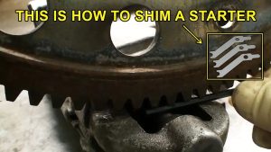

It made a hideous grinding noise. Not the engine – which wasn’t turning over – but the starter. More finely, the starter’s pinion gear, which was not meshing smoothly with the new flywheel. It needed to be shimmed. Meaning, the starter wasn’t quite lined up correctly with the flywheel. This happens sometimes with older vehicles. The tolerances are more loosey-goosey than they are with modern vehicles. Adding shims – they come in various thicknesses – restores the correct relationship such that the pinion gear on the starter motor engages precisely with the flywheel’s teeth.
It is a lot easier to gauge this with the transmission (and bellhousing) not installed. I wish, in retrospect, I had thought about that while the transmission was not installed. But I didn’t think of it. I assumed that the starter I had used before without having to shim it would work just as well again, without having to shim it. But the new flywheel had other ideas. Probably because it was brand new, with zero wear on the teeth. The old automatic flexplate had been in place for 50 years. Maybe that was why I got the grinding.
To stop that, I had to do some shimming. This is something of a pain-in-the-ass with the transmission and bellhousing installed because you cannot directly see the pinion gear/flywheel meshing, to gauge the clearance and make the fine adjustments. Instead, you have to add (and subtract) shims until you get it right, which is established by the starter engaging smoothly and turning the engine over.
Two shims finally did the trick. After a going-on-four-month sleep, the Trans-Am’s 455 came back to life! I let it warm up and settle into a normal idle. Then it was time to see whether I had bolted everything else together correctly. I got my three ton floor jack and used it to jack up the rear axle enough to let the rear wheels hang freely and got back behind the wheel, pushed the clutch pedal in and moved the Hurst shifter from neutral to first and gently let out the clutch for the very first time.
