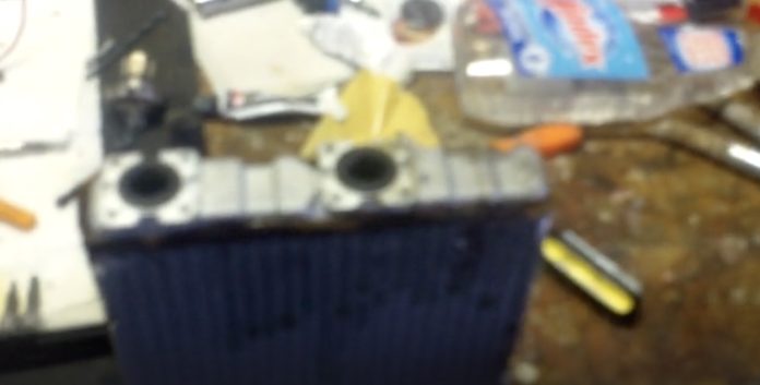

I finally got the leaking heater core out of my old Nissan Frontier (’02 model year, so now 23 years old) and found a couple of interesting things that you may find interesting – especially if you happen to own an older truck. Or an older car or crossover/SUV, for that matter.
The first thing is that my old core was clogged – as well as leaking. Once I got it out and on my workbench, I was able to see inside. The internals were gunked up with something and that almost certainly accounted for what I always thought was the mediocre heating of my truck’s passenger cabin, which I attributed to “just the way it is.” Some vehicles have better heat than others. But I no longer think it was that. I think the previous owner either used Stop Leak in the cooling system – which stops radiator leaks by plugging small holes, so as to mask but not really fix the problem while also filling the system with funk that plugs up the system. Or he used contaminated (tap) water radiator in the system, which can lead to calcification build-up.
I think so because I remembered the truck’s engine ran hot when I bought it about 15 years ago. I had to replace the radiator – which cured that problem. But it did not fix the heater core, which remained a latent (just not yet leaking) problem for the next 15 years. Stop Leak is n expedient. It isn’t a repair. It is often used by people selling a vehicle with a leaky radiator that don’t want to pay to replace the radiator before they sell (or trade) the vehicle in. Using tap water is another expedient in that it’s easier than going to the parts store for a jug of coolant. But you ought to – if you want to avoid down-the-road (and possibly expensive) problems with your vehicle’s cooling system. It is also important to be sure you use the correct, factory-specified coolant that is compatible with your particular make/model’s cooling system. This information will be in your owner’s manual and also sometimes on the radiator fill cap.

In my case, the critical parts are a pair of transfer tubes that convey the warm engine coolant from under the hood to the heater core under the dash and then back to the engine, to be warmed up some more. These two tubes bolt to mounting bosses on the core and so you absolutely have to have them for the system to connect. You’d think just having outlet nibs on the core that generic hoses could be fitted onto and tightened up would be smarter but it actually isn’t because those hoses are made of rubber and they will eventually deteriorate and leak.
Then again, so will plastic – which is what these tubes are made of. As I mentioned in my earlier report about this project, I decided it would be smart to replace those 23-year-old plastic tubes with brand-new ones that would last another 23 years. Also, they’d come with new o-rings to replace the 23-year-old crushed and tired o-rings that were attached to the old core.

On the upside, it is also true that replacement parts for discontinued parts are available from aftermarket suppliers, as on eBay. That’s where I found a set of new tubes for my truck and I’m waiting for them to arrive so I can put everything back together and have heat – hot, this time – again!

I’ll be draining/flushing the system before reconnecting the new heater core. It’s also a fine time to change the hoses to the core as well as any related thing that needs attention. Hopefully I’ll have it all back together by the weekened!

I found (and ordered) the replacement tubes on eBay. The will bolt properly to the bosses on the core – and they come with new o rings, which will replace the crushed ones that are there now! Should have it all back together by the weekend, assuming the parts get here before then!

I had a feeling stop leak was involved in your case. Heater cores w plastic end tanks fail by separation slowly drip by drip and sysyem pressure loss.
Stop leak allows pressures to build to explosion point.
