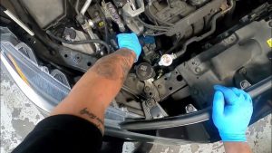

Replacing a water pump is usually a simple and easy job – if the vehicle isn’t FWD/AWD. If it is, the engine will be mounted sideways and the side on which the water pump and all the other accessories are mounted will often be snugged up very close to the frame/bodywork such that you have very little room to work with. That’s bad enough, but when you need to apply a lot of leverage to get a tight bolt off, it can be a whole lotta fun!
The first step with the RAV4 is to break loose the four bolts that hold the pulley on the water pump snout. This is harder than it sounds because there’s so little room to work with and if you haven’t got an extra-long 12 mm wrench you will have a time getting enough leverage to break the bolts loose. As an aside, you do this part before you take off the serpentine belt, which keeps tension on the pulley and prevents it from turning when you try to turn the bolts, to break them loose. In my case, the belt tension was not enough to keep the pulley from turning as I tried to turn the 12 mm bolts. I ended up using a vise grip on one of the four bolts, which I used not to turn the bolt but to keep the pulley from turning – by using the vise grip on the one bot to stop its travel as it wedged up against the motor mount – while I using my 12mm wrench/breaker bar to break the tension on the other three bolts. The I moved the vise grip pliers to one of the other three and loosed the last stuck bolt.
So much for the pulley.

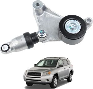

But still needed to get the serpentine belt off. On the RAV4, there’s a 14 mm tensioner bolt you leverage to create enough slack to slip the belt off. But first, you’ve got to loosen another 14 mm bolt that secures the tensioner bracket to the side of the engine. To even be able to see it, you have to be under the car, with the passenger side front wheel and the plastic splash guard in the wheelwell area removed first. The bolt is easy to see then – and easy to reach, too. But you’ll probably need a breaker bar on the wrench to get the leverage you’ll need to break it loose. Once it’s loose, you can use a 14 mm socket and a breaker bar to leverage the tensioner bolt and slip the belt off. There is a special tool for this but you don’t have to have it. The job is easily done from below, where you can apply more force more easily while lying on your back than standing up.

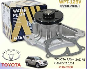

Then it’s just five 10 mm bolts to get the old pump off (you’ll also have to remove two larger, 14 mm bracket bolts to allow the alternator to be moved back enough for clearance). Then reverse everything to finish the job with the new (non-Chinesium) pump. It’s not so easy peasy Japanesey – because of the tight working space that attends the FWD/transverse engine layout. I can replace my truck’s water pump in less than an hour because everything’s accessible and no funky/home-made tools are needed – because its engine is front to back and so the front of the engine isn’t snugged up against the frame, like the RAV4’s is.

By the way, it is apparently not possible to remove the upper 14 mm tensioner bracket bolt due to it being a long bolt and there not being sufficient clearance to get it out with the engine installed. The “procedure” is to undo the motor mounts and raise up the engine! A work-around is to cut off the bolt head then extract the stud and – when re-installing – use a slightly shorter bolt that can be wriggled into place.

The big question, since you changed the water pump.on a Toyota, is: Did you use the SPECIAL gasket? If you’re wondering what I mean, you didn’t notice why this gasket shape is “special “.
