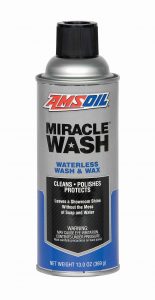

So, the pipes came off for careful cleaning and polishing. This was necessary as well in order to gain adequate access to the Kaw’s underside, where the dust had congressed with the oil that a two-stroke leaks from every pore as well as puffs from its pipes – and this can only be dealt with successfully via up-close and personal, fin-by-fin and casting by casting wipe-downs with a soft old towel and a bottle of spray detailer.
This is less harsh than water and a brush. Better, too, as the water (depending on your area) may have things in it that will discolor/stain what you’re trying to clean and can also accelerate the rust you’re trying to prevent. Water also gets sprayed gets everywhere – and can stay there, if you haven’t completely dried the bike off, which may not be feasible if it’s not in running order.
The spray detailer is just the right pH – and the cloth is gentler. Spray some onto the cloth, then work it through each cooling fin (modern water-cooled bikes lack them, which further homogenizes them and is the reason why most modern bike engines are hidden underneath colored plastic; there’s no much worth seeing under that plastic) and then into and around the ridges and valleys of the cases.
Wipe down the frame tubes and swingarm, too.
The spray detailer is also just right for the seat, the gauges and turn signal housings. It’s important to keep abreast of the towel’s condition and change it out as dirt accumulates . . . before too much accumulates, otherwise you’re more sanding than cleaning.
Chrome polish for those NOS “correct” Kawasaki rims, also applied using the towel and by hand. This is the most arduous detail of detailing the two-wheeled blue Barchetta. You have to get around the spokes – and do them, too. There are about two dozen.
Then work around the nubs, bringing the inner rim to shimmering perfection. Don’t forget the sides.
