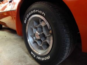

For example, there’s more to check than just the air in the tires. Cars that are driven regularly usually wear out their tires before the tires age out. Cars that aren’t driven regularly often have tires with plenty of tread but hairline cracks on the sidewall and maybe also structural deterioration you can’t even see – the result of age and oxidation of the compounds that make rubber pliable.
My car is driven maybe 500 miles each year. Its tires will never go bald . Well, maybe the rear tires will – from burnouts – but you get the point. Unless you drive your classic car at least a few thousand miles each year, it is very likely the tires you buy today will still have most of their tread a decade – or even two – from now. But by that time, they may no longer be safe to drive on.
If you see cracks, it’s a clue that it’s time for new rubber. Send the old ones to Valhalla via celebratory burnouts!

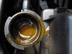

Oil and filter change. My practice is every spring, regardless of mileage. As with tires, the passage of time is the determining factor here. The oil does not wear out – certainly not after 500 miles (or less) of driving in a year.
But it does get contaminated. By gas especially, which inevitably leaks down into the crankcase from the carburetor – a fuel delivery device that most cars made before the mid-1980s used. And by short-distance driving. Older cars do not warm up as quickly as modern cars, which are specifically designed to – in order to lower their emissions. Older cars weren’t – and if driven short distances or just fired up and allowed to idle a while in the garage during the winter months – will accumulate things in the crankcase that are not good for them.
Changing the oil and filter purges out the not-good-things and the fresh oil coats all those important things with the lubricants and anti-wear additives your old car’s engine deserves. If it’s an engine with a flat-tappet camshaft (which is almost all American car engines made before the early ‘80s) it is really important to get oil that has the zinc/manganese additives (ZDDP) which off-the-shelf oils no longer have – for emissions control reasons. AMSOIL sells such oil – see their ZRod line – or you can buy the additive to add to off-the-shelf oil.
