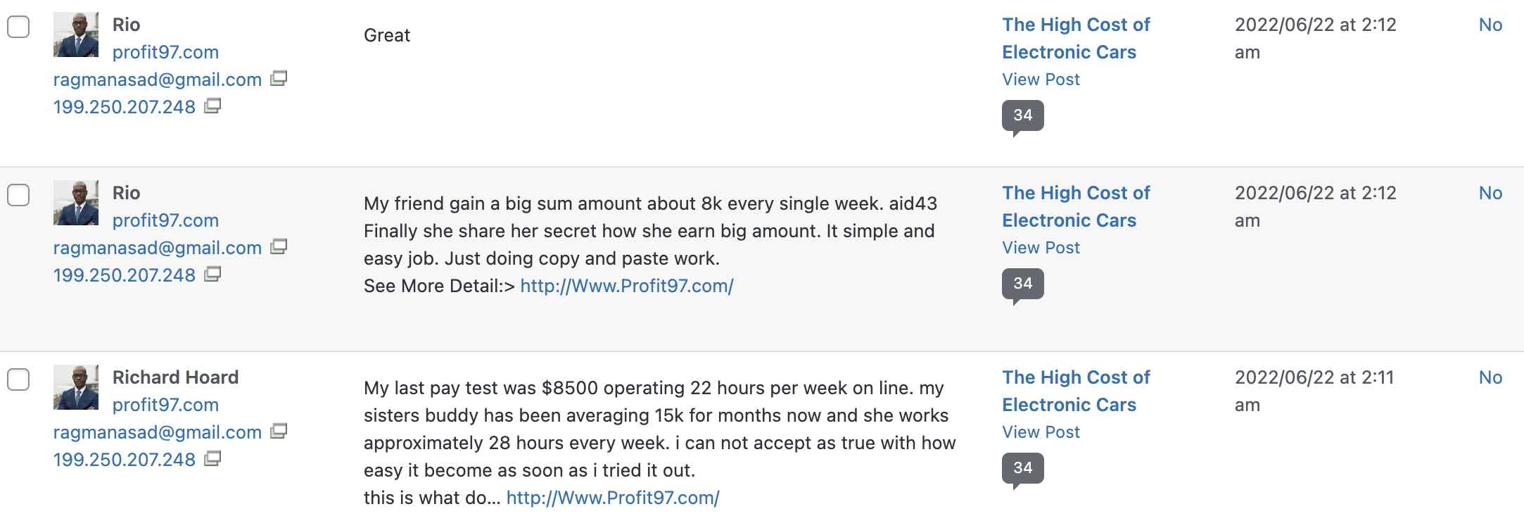

I wanted to hip you all to a slight problem we’ve been having with spam, specifically the spammer in the image accompanying this little note. I put “Rio” in the trash but that caused many legitimate posts to also get forwarded there for some reason. Hopefully, that’s been corrected. My apologies for “Rio” – who has received something special in the mail from me as a thank-you.

  2. I don’t really know the first thing about WP, but I do have long experience securing servers from network attacks. I was just pointing out that the three posts in your snapshot mention is IP address, and all three are the same. Packets on the internet are routed (sent down the correct pipe to the next router) based on the “block” of sequencial numeric IP addresses that it’s a part of (BGP4). The IP that spammer was using gets routed to “In Motion Hosting” in El Sugundo, so it’s likely not a personal computer, but rather a server being hosted there. I can see that server is running a web server, multiple different kinds of mail services, a file transfer server, and a database server (sql).
    I’m guessing hackers found a bug in one of those programs, and used it to get control of the computer, and then sold access to spammers (who are likely not in El Sugundo). The guy paying the bill for that server probably has no clue that any of this happened, and that “his” computer aint really his anymore.

  4. further: it’s running “Pure-FTPd”, Exim (mail), and MariaDB (sql), so it’s almost certainly a *nix derivative, but it’s *not* running ssh, so the admin is likely clueless. (seriously, nobody runs ftp anymore for security reasons)
  5. 199.250.207.248 belongs to a hosting service in El Segundo.
    Very likely a compromised server now “powned” by a hacker or botnet.
