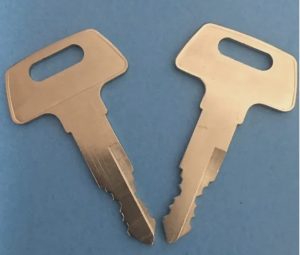

Somehow, I managed to lose the one key I had for the Silverwing. Which I’ve managed to not lose since I bought the bike about 12 years ago. That’s a miracle in and of itself as I am the absent-minded professor type who instantly forgets where I just a moment before left something. But – saving grace in this case – I usually just left the key in the ignition. This time, I left it somewhere else. Only God knows where.
I looked everywhere but could not find it. I will probably find it after I get a new key for it. Which is going to take more than getting one cut. Because without a key to serve as the pattern, you can’t get another key cut.
You must have the code.

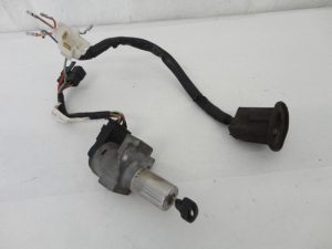

And that code is stamped on the ignition lock cylinder, which must be removed to be able to see what the code is. This entails some disassembly. Not difficult, especially. But a hassle and in the meanwhile, you can’t ride the bike. Not very far, that is. Because even if you did a hot-wire end-run around the ignition switch, you won’t be able to unlock the gas cap, which uses the same key as the ignition switch does. And if you have a bike with locking storage bags, you won’t be able to unlock those without a key, either.
That also means you can’t just replace the ignition switch with a new one because it will use a different key. You’d be able to start the bike. But it’d only run until it ran out of gas. And you wouldn’t be able to carry anything much, either.
A thing to know about bikes – whether newer or older – is that unlike cars, the key info is not generally tied to the bike’s VIN.
Having a title/VIN shows you own the bike but those documents do not have the information needed to cut a new key. Newer bikes may not even have a code stamped on the switch, in which case you may have to learn an even harder lesson if you lose the keys.
With older bikes like my ’83 GL60, the dealer may no longer have the necessary code book to cut you a new key even if you can give them the key code that you found stamped on the lock cylinder.
Or the specialty cutter needed to make a key for the bike.
My Honda dealer recommended a local specialty locksmith that could make me a key – once I got the code. But first, I had to remove the ignition lock cylinder from the bike because you can’t see the numbers stamped into it until it’s been removed, for the obvious and sensible theft-deterrent reasons.
So I rolled the bike into the garage and got busy.
On the Silverwing, you have to remove the windscreen from the fairing in order to be able to get at the 10 mm nuts that hold the instrument cluster in place. Which you have to unbolt in order to move the cluster out of the way, so you can reach the 10 mm bolts that hold the ignition lock cylinder in place. Then it’s just a matter of unplugging the switch from the wire harness and now you can see those all-important numbers.
And now you can go to the specialty locksmith place to get at least three new keys cut. One for the bike. One for when you lose that one. And one more for when you lose the second one and couldn’t be bothered to get a replacement for that one cut while you still had another key to use as the pattern.
