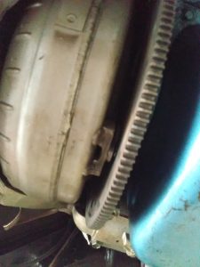

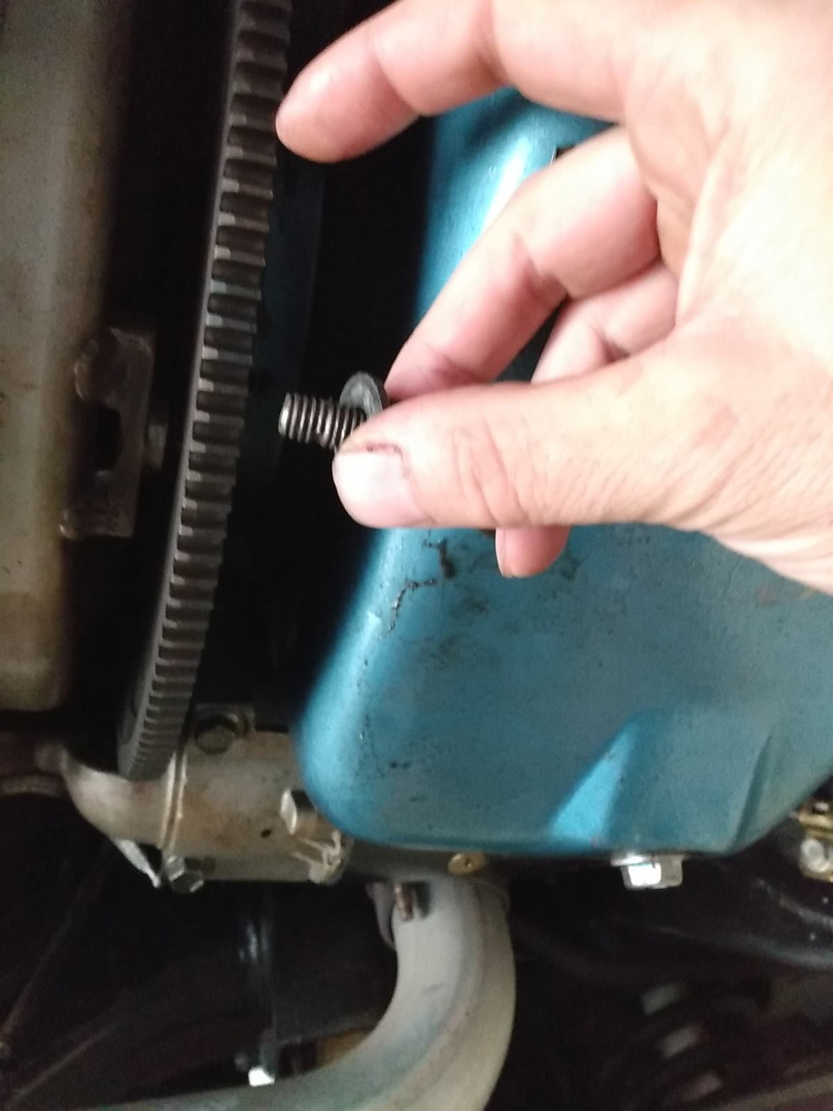

A stubby little bolt on the garage floor. As soon as I saw it, I knew what it was – for the same basic reason some couples who’ve been together for decades know each other’s thoughts before either of them say anything. I had installed that bolt, a long time ago. It was a torque converter bolt – one of three that secure the torque converter to the flywheel. And that meant that – at best – there were only two still holding the converter to the flywheel.
Back into the garage the TA rolled. More finely, onto the lift – and up she went. And I soon ascertained I was right. It was one of the three torque converter bolts that had worked its way loose – and fallen off. Right on the floor of the garage, where I would see it. As opposed to while i was driving it.
All I had to do was to re-install the bolt, an easy-peasy job that involves rotating the engine by hand with a breaker bar on the crankshaft pulley bolt to turn the flywheel/torque converter until the pad on the converter where the torque converter bolt goes can be easily seen and reached and then thread and tighten the bolt (with Loctite, of course).
It would not have been so easy-peasy had the bolt worked loose and fallen off while I was driving into town. Especially if the other two had done the same. I’d have had to get the TA towed home so I get under it and fix it. But I didn’t have to do that because she spit that bolt right there on the garage floor, where I’d be sure to see it before I drove far away from my lift, tools and garage.

  3. It will happen again dummy, why do you think it fell out in the first place?!?!
    All you had to do was use some permatex threadlocker gel red on it!!!! Flywheel bolts (or your equivalent here) are one of the things this is verbotten to not use threadlocker. On the threads or in the hole if it’s blind, and you don’t have to use a lot either! Go to school to be a mechanic and you’ll know this.
      • Eric,
        Based on what happened, and your picture, it doesn’t appear to have been enough.
        Flywheel bolts definitely use red locker, and if I have to do them again I’ll learn from this experience and use maybe a bit more than the permatex rep said to use the stuff (one swipe).
        Makes since, since ARP bolts for this sort of thing regularly come “coated” with threadlocker.
        I guess the lesson here is don’t skimp on the locker when it comes to flywheel (or flexplate/TC) bolts.
        Also sounds like you performed the test for loose flywheel bolts with what you did with the carb.
        If the bolts were loose, it makes a large cracking sound (depending on how loose) when snaping the throttle like that. I bet the Orange Barchetta is pretty loud by the look of it, might not have been listening for the sound or it may not have even occured, it’s really more of a maybe, but sounds like you preformed the test alright and it left you a bolt. Sounds like love to me, gotta love old cars, as opposed to soulless devices. Cheers!

  7. Looking at the torque converter bolt in the picture it appears to have at least one damaged thread, hopefully it is better than it looks but you know what I mean.

      Yup – the thread was damaged; new bolt installed. To answer Jim’s question, the TA never goes out in weather so that’s why the cover’s not on.

  9. “Torque converter” bolt, Kemo sabe? What is this mysterious “torque converter” thing you speak of?
    My vehicles have pressure plate-to-flywheel bolts….
    • Likewise, I’m taken aback by photo 2 above. In every vehicle I’ve had, the flywheel would be behind a cover, so that a loose bolt could not fall to the ground. Is it really exposed like that? What lubricates the starter pinion and the flywheel teeth?
