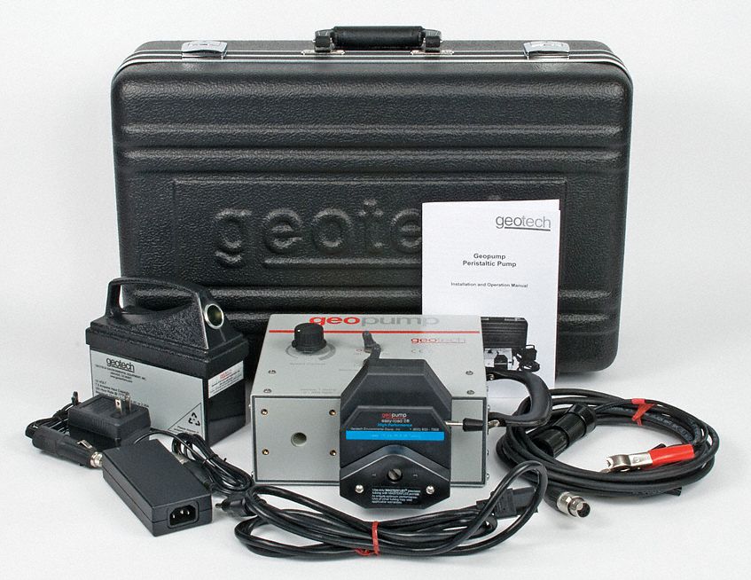

I use a small peristaltic pump for things like that.
Did you buy it or rob it out of something like an IV pump or similar. I ask because I don’t ever see a really small pump like that although it would seem to be the ticket for small amounts of low viscosity fluid.
Neither, we have three of them at work (use them all the time for groundwater sampling).
http://s.gc1.co/is/image/Grainger/8TUF8_AS01?$s7product$
They will handle any fluid found in an automobile but do have trouble lifting high viscocity liquids from depth (will lift water from ~27′) – which is not an issue in an automotive application.
