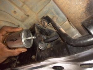

The good location is somewhere under the car – as in the case of my ’02 Nissan Frontier, the guinea pig for this article.
Because you can get at the filter.
If it’s a truck, like mine, you may not even need to jack up the vehicle to reach the filter. You can just shimmy underneath with a flat blade or Phillips head screwdriver – to loosen the worm gear clamps that hold the rubber hose sections to the inlet and outlet nipples of the old filter and (gently) slide the hoses off the old filter.
It’s a good idea to use a hemostat or vise grip pliers – adjusted to not squeeze too tight – to clap down on the hoses just aft of the inlet/outlet nipples before removing the old filter; this will prevent gas from leaking out of the hoses while you are in the process of installing the new filter.
Whatever you do, don’t leave the ignition switch in the “run” position while you do this job. If you do – and if you haven’t clamped the lines – you’ll get soaked with gas, which will be pumped out of the open lines by the electric fuel pump that all fuel-injected cars have. Back in the carb days, cars had mechanical fuel pumps – and they only pumped when the engine was running.
What’s the same as before is to make sure you install the new filter in the right direction; there’s usually an arrow stamped on the body that will tell you which way. Be sure you don’t install it the wrong way.
Now is also a great time to check the condition of the rubber hoses that usually connect to each end of the filter – and to the hard steel fuel lines.
If they’re brittle or you see cracks, replace them. Even if you don’t, if the rubber’s more than eight years old, it’s good preventive maintenance to replace them now – before they leak. Be sure to get hose that’s made for fuel-injected vehicles as the line pressure is much higher than it was back in the carb days.
And use a good-quality filter. This is at least as important s replacing the filter – because a crappy replacement filter can be just as bad (and maybe worse) as not replacing the filter at all. I personally like and use Wix filters (gas and oil) and recommend them, not because Wix is paying me to recommend them but because they’re good filters and worth the couple of extra bucks you’ll pay up front vs. what you might end up having to pay down the road if you go with a poor-quality filter to save a few bucks up front.
