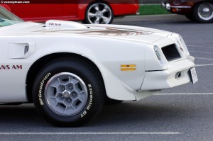

One of the things I really like about my ’76 TA is its Honeycomb wheels, which are unique to Pontiacs of that era and (like the air bag-free Formula steering wheel) really set it apart. If I were to replace the Honeycombs with a set of 18 or 19 inch modern wheels, I’d have to give up the unique and special appearance of those (to me) extremely cool Honeycombs in favor of something non-specific, similar in appearance to the wheels on other modern performance cars. And yes, I know one can buy aftermarket Snowflake wheels for the TA – but these are wrong for my ’76 as the original Snowflake wheel was first offered in ’77 – and in addition to that, they’re just too got-damned big (18 inches).
Ditto the eighteen-inch aftermarket Honeycombs – which are made of aluminum and not “Polycast” like the original steel wheels with the urethane surface.
