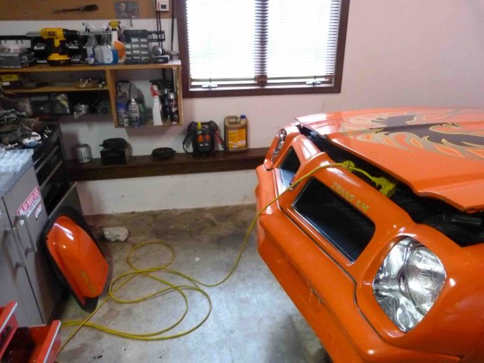

In any event, back in the safety of drydock – and access to tools.
With trepidation, I dropped the pan, wondering whether anything would drop out with the pan; whether anything other than fluid would be in the pan. Chunks of things are never a good sign. But – as luck (so far) would have it – no chunks or anything unusual. Just the fluid and a little very fine silt, normal to find in the pan.
So, what next? Suspicion fell on the governor, a gear-driven thing with weights and springs that reacts to spinning (centrifugal force) to govern the shifts. The Pumpkin’s tranny – not Bruce – is a GM TH2004R and these things apparently have a weakness in the governor. The spring sometimes goes and when it does, so do your shifts. So I pulled the governor out of the valve body – the hydraulic circuit box that is the heart of every automatic – and looked to see.
But the spring was fine and the governor seemed ok.
Which is good but doesn’t explain the lack of shifts. There is an electric solenoid that could be the source of the ‘infection.” Another possibility is a stuck accumulator or a little piece of something in one of the many tiny hydraulic passages, which is a possible consequence of long periods of sleep.
The TA only comes out once a month or so – and less, lately Because Corona. The fluid only had about 2,000 miles on it but then so do the tires – and they were new back around 2002.
One other contender is the TV – throttle valve – cable, which needs to be adjusted just right for the shifts to happen right. It’s possible the cable is out of adjustment. Or – and this can be determined easily with the transmission’s undersides exposed – the lever it’s attached to that’s supposed to depress a plunger that tells the tranny (not Bruce) when to shift could be awry.
So, we’ll see.
Everything goes back together  – after rechecking everything that can be checked without actually taking the tranny out (not for a date; sorry, Bruce) later this week, once the parts I need arrive.
