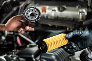

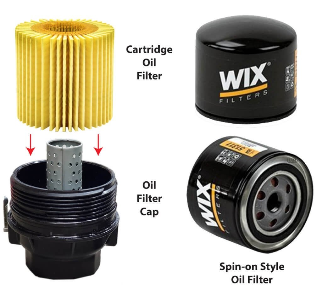

Have you got a new/late-model car with a cartridge rather than spin-on oil filter? The latter have been weirdly disappearing in favor of the former, which were nearly universal until just a few years ago. What’s the difference? Why does it matter?
And why the change?
The difference is obvious. A spin-on (and off) oil filter is a self-contained, one-piece filter that houses the filter in its own  . . . housing. It spins on a threaded male fitting and that’s all there is to it. Spin-on filters can be installed and removed by hand, without tools – assuming whoever did the last oil change didn’t install the old filter more than about a quarter turn past hand tight. Even if you do need an oil filter wrench to get the old one off, the task is simpler because there’s nothing else to do.
At least insofar as getting the old filter off.
Replacing it with the new one is the same easy process. Just spin it on and tighten it. Being sure to wipe off the mounting boss and also making sure the old oil filter’s rubber gasket didn’t stick to the boss. Some like to fill the new filter with oil prior to install to accelerate the build-up of oil pressure at re-start. That’s pretty much the end of the story. Except for the one thing that is the reason why spin-on filters are being replaced by the cartridge type that are are more complicated because there is some disassembly involved and so more mess involved – which is ironic given the reason you’re about to read about and may have already guessed.
What do you do with the old spin-on oil filter? Probably, you throw it in the garbage.
Oh, the humanity!
The spin on filter is harder to recycle, because it is made of metal and the paper element parts, plus some plastic/rubber gasket and it is likely to contain more used oil than the old filter element of a cartridge-style unit, because most of the old oil was in the housing – and for that reason it’s now probably all over your garage floor or work bench rather than in the trash.
It is hard not to spill some of the old oil during the disassembly process. The expectation of the “environmentalists” is that you will do the disassembly of the cartridge housing/filter over a catch pan and thus most of the old oil will go in the catch pan and from there to a “proper” disposal place for recycling, while only the old filter element will be tossed in the trash.
The reality is there’s likely to be more spillage onto the “environment” – as well as your hands – and there’s no debating that it’s a messier job now that generally requires a special tool to loosen/tighten the cartridge housing. One more thing to buy. Several more things to do.
Another thing to take into account is that the housing part of the cartridge filter system is almost always made of . . . plastic. That wonderful material that gets brittle and cracks as it ages. At some point, it is likely you’ll have to replace the housing as well as the element within. More plastic, in other words, tossed into the “environment” (as well as extracted from it in that making plastic requires – here it comes! – oil).
The beauty – one of them – of the spin-on oil filter is that it’s made of metal, which is inherently sturdier. But the more fundamental thing is that it’s a self-contained assembly; the whole works, as it were. Every time you replace a spin-on oil filter, you have replaced the works, in other words. It’s as if that part of the vehicle had just left the assembly line. With cartridge-style filters, you’re re-using an old part, over and over again.

  1. Corollas had those (we called them “Euto-style”) a little while, and went back to the regular ones.
    Personally I like them, except for the fact that the housing is plastic and people tend to WAY over-tighten it.
    Makes it easier to check to see if there is gunk collecting in the pleats.

  17. Is there a law or standard driving these element style oil filters? I haven’t heard of one.
    My guess is they are cheaper for the manufacturer. What they avoid is the need for a machined surface on a casting for the spin on filter to seal to. Be it the block or separate piece. Actually for cars where the oil filter mounts to an oil cooler or some separate piece multiple machined surfaces go away.
    It’s very easy to have a nice sealing surface on an injection molded plastic part. You have to pay attention to it once when the mold is made. Or multiple times if there are several cavities in the mold, but that’s it. It’s in the tooling. Every part will then come out ready to go.
    Modern resins shouldn’t have any long term problems. That is if they chose the right one and paid up for it.
    • “ What they avoid is the need for a machined surface “
      Bingo. Every metal machining step removed = $$ saved. Tool up the plastic process to include molded threads and sealing surfaces wham bam done. Now the engine block has less machine time, fewer cutters to sharpen, less cutting fluids.

  19. The plastics concern me. 2018 Jeep V6 has the top mounted cartridge filter. Easy to change and I can do the removal without making a mess. Cartridge stays in the cap for removal, right into a plastic bag then grab the old cartridge with the plastic bag and pull the cap.
    That plastic cap after 7 years is showing its age. Buy a new cap sure. However the base piece is also plastic and that’s a major tear down to replace if it gets damaged or ages out. I marked the cap and base with a white paint pen the first time I changed the filter to ensure the cap went on snug but not too tight, just line up the marks.
    Also the pressure relief valve is in that cap and there is a factory bulletin to NOT rock the cartridge to remove, ONLY pull it straight off to prevent damaging the relief valve. Another reason to DIY oil and filter change. I don’t think Cletus at the quick lube would be aware and the “quick lube” means he’s always in a hurry no thanks.
    • If that’s a 3.6 Pentastar, that whole plastic filter/cooler abortion is a known issue. Fortunately the Chinese aluminum replacement is not too speedy and the job on a caravan ot T&C is not too long or difficult.
