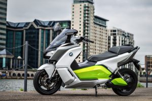

WHAT IT IS
The C Evolution is BMW’s electrified answer to regulatory fatwas in European countries that forbid or hugely restrict anything that combusts – no matter how cleanly – from setting foot in certain areas. These anti-IC fatwas have yet to spread their dark shadow here, but it’s probably inevitable and since BMW has to make these things for Europe, they probably figured why not at least try to sell them here, too.
The Evolution is similar in size and general layout to BMW’s gas-engined scooters, such as the C 650 GT and Sport –  but with an electric motor and battery pack under the seat rather than an internal combustion engine for motive power.
You plug it in rather than gas it up.
Base price is $13,750 – vs. $10,095 for the IC-engined C 650 (reviewed here) which when you take the cost of fueling the gas-engined scooters into account, isn’t that great a gulf.
You might even reach break-even before the thing’s paid off.
ABS, reverse assist and four driver-selectable modes are standard.
The major optional amenities are heated grips ($250) and a Comfort Seat ($145). A smartphone cradle is also available.
A plug-in charger that works with any 110V household outlet is standard, but the Evolution can also be topped off faster – that being relative – using a 220V “fast” charger, if you buy the optional wall box and have it wired up by an electrician.
WHAT’S NEW
The C Evolution is BMW’s first electric two-wheeler (the i3 electric four-wheeler beat the e scooter  to market by a couple of years).
It is touted as being primarily for “urban mobility,” but its respectable range – potentially as far as 99 miles, if you keep it in Eco mode – is enough to make it serviceable for suburban-to-urban operation and possibly back to suburbia  . . . without a plug-in session.

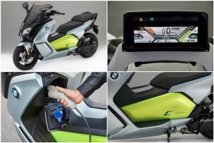

BMW supplies a recharge kit, located underneath the passenger’s seat. It is designed to look like a gas pump nozzle and plugs in to a port located behind a cover to the left of the steering head. The other end plugs into any common household outlet; a circuit monitor box keeps track of the charge process and lets you know – via LED indicators – when the process is complete.
It takes about eight hours (depending on the state of charge) using the standard household outlet. The “fast” charger reduces this to about four hours.

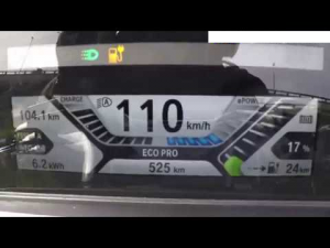

Charge/range status is also displayed on the scooter’s main LCD gauge panel. This updates as you ride, taking into account how you ride.

Range has improved, no doubt. I rode the fully charged Evolution from my place to the coffee place in downtown Roanoke where I sulk and was able to make it there and back home – a round trip of about 65 miles – without running out of juice.
Just barely.
I did it by keeping the scooter in Eco mode – which limits speed to about 60 MPH as well as the power output of the motor and maximizes energy recapture via regenerative braking. This left me about 18 miles of range, according to the scooter’s info display – and about six hours to recharge before I could use the scooter again.

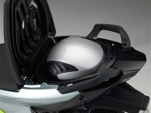

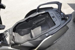

One other thing the Evolution offers less of is storage capacity.
The C 650’s storage area…
The IC-engined BMW scooters have more room for stuff than most full-dresser touring bikes. This is no joke. You can lift up the rider’s seat and underneath that you will find space enough to hide a body. And not Verne Troyer’s body.
In the Evolution, this space is hogged up by the battery pack. All you get is a much smaller space under the passenger seat – and about a third of that is taken up by the power cord/plug-in rig. I was just barely able to squeeze a Macbook laptop in there, along with the power cord – which you don’t dare leave behind.
The Evolution’s storage area…
There are two additional map-pocket-style cubbies near your knees, built into the lower part of the scooter’s front fairing – but these won’t hold much more than a sail fawn and your wallet.
If you need to carry more than a laptop, you’ll need to add side bags or wear a back pack.
