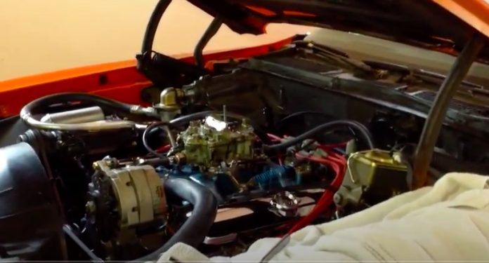

Here’s a quick video about eliminating possible sources of the tranny troubles my ’76 TA has been having. The car has a not-factory tranny – a TH2004R, which is in the car because it has overdrive, a big helpful thing when you’ve got an old muscle car with 3.90 gears in the pumpkin. Without overdrive (a deep .067 ratio in the TH2004R) the engine would be spinning around 3,400 RPM at 65 or so. With it, the revs drop to just over 2,000 at the same road speed.
Anyhow, last week, the the tranny developed trouble. It wouldn’t shift into overdrive – and then it wouldn’t shift from second to third. I gimped it home in second – and since the, have been trying to suss out the trouble.
The first thing I checked – after dropping the pan and draining the fluid – and looking for things other than fluid in the pan – was the governor. This is a mechanical thing that looks kind of like a spinning top and works more or less the same. Weights mounted on a shaft expand outward in response to the speed of the spinning shaft. There is a small spring – a weak point – that sometimes breaks and causes the governor not to. Shifts don’t – or do, but not right.
So I took the governor out and inspected it; all kopacetic – so back in it went. The next thing to check – the subject of this video –  is the  throttle valve (TV) cable. This cable operates a lever inside the transmission, that depresses a plunger inside the valve body – the hydraulic control box of an automatic transmission. It is very important that the cable tension be adjusted properly, so I decided to make sure it was. It seemed to be. Check!
The next thing to check will be the torque converter lock-up sender and related parts. Assuming they check out, the plan is to button it all up, fill it with fresh ATF – pray to the Motor Gods – and see what happens.
If nothing good happens, I foresee a Hurst-shifted (by me) Super T10 in the TA’s future.
Maybe it’s a sign from the Motor Gods!
